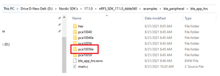

There was never an official Dev Kit made for the nRF52811. So, when using the nRF82811, you should use the examples for the PCA10056e. See how they work for you.. Shown below if from the directory where the Heart Rate example from nRF5 SDK is located.
ble_app_hrs_pca10056e_s112.hexxc
I hope this helped.
