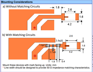

1) In the datasheet of the chip antenna there are 2 options. One with matching circuit and one without. Do I need this extra? Because the L1 en C3 are included in the reference design of the nrf52811.

    you need a separate matching network for the radio and one for the antenna. If you need one component, a T- or a Pi-network depends on the antenna.
    For the one you have listed here a T-network i recommended, and I strongly recommend you to add the T-network and go for option b) from the antenna vendor.
    Illustration, here is the antenna matching network illustrated as a pi-network, bit a T-network is also fine!

    Chip antenna: Higher BOM, but the antenna is small. The downside is that it usually has less gain. It requires a matching network, based on the vendors recommendations. It has a lower bandwidth than a quarter wave monopole antenna so it can be sensitive to detuning.
