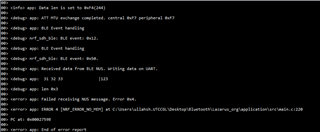

Not able to send data over uart from nrf52840 ble to app
I am using nrf52840, SDK v17, SES v5.10 ble_app_uart example for the development.
I am able to send data from the nrfConnect app to uart but not more 1 byte at a time and not able to send data from UART to the app.
while i debug the code i am able to receive data from the app to NUS data handler for example if i send "123" able to receive on BLE_NUS_EVT_RX_DATA event but not able to send to uart peripheral if more than 1 byte at a time. while sending data using serial port on UART, my uart_event_handler is not getting executed.
Can anyone please help me in solving the issue.

  • Hi Shafi
    Are you testing this on a standard nRF52840DK, or on custom hardware?
    Have you made any significant changes to the example?
    I see there are some changes in the main file you shared, but they don't look very dramatic. Have you tested the example out of the box, without any changes made, to see if the issue is the same?
    What kind of phone are you using for the testing?
    Best regards
    Torbjørn
