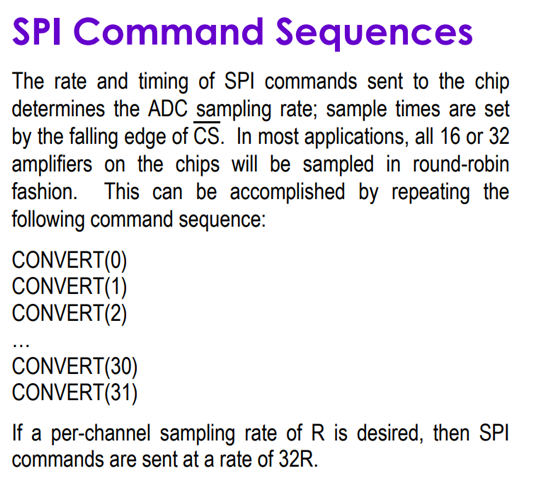

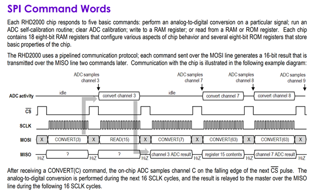

This application is working fine, but when the timer period is set to 1 MSEC, the main loop will be blocked, and the main problem I think is the low operating speed of the spi_transieve function.
As a reference, when using spi_transieve API to send a data array in one spi_transieve calling, the speed is same as the spi_config setting. However, using the round-robin fashion to send the same size data with many spi_transieve calling, the speed is going to slow down, and the gap is huge, like ten times.
But using the round-robin fashion is the recommended way by Intan to configure the RHD2216 chip.
Please let me know if this spi_transieve API can be faster in the round-robin fashion to meet the Intan chips' demand.
I have attached my code along with a link of the data sheet for Intan RHD2216.

http://intantech.com/files/Intan_RHD2000_series_datasheet.pdf
  • The spi_transieve API puts SPI initialization and data transfer under the same API, which leads to a significant drop in the speed of multiple calls. I think this is the reason, but I'm not sure.
    spi_transceive should only do configuration if the passed config have changed. Do you change the config between each transfer? If you want more CPU time, you can use spi_transceive_async() API, to do async transfers. Then your CPU can do other tasks while the transfer is ongoing, and you will be notified in the provided callback when the transfer completes.
    Jørgen
  • Thank you for your prompt reply. I also noticed that spi_transcieve checks for config changes, but I didn't change config with each loop, and the SPI_Transcieve API is still much slower to send data in a round-robin call than to send the same size data in a single call. I have attached a sample code to test the duration of two SPI sending fashions. I hope this code can explain the problem that confused me.
    I am also trying the asynchronous SPI sending mode, but the Arduino sample code given by Intan uses the round-robin fashion directly.

  • I'm not sure exactly what you mean by "send data in round-robin fashion", but in your code it looks like you are calling spi_transceive() in a loop 10000 times, to send a single byte? This will clearly take much more time than a single transfer with 10000 bytes, as there are overhead to start and end a transfer. Is there a problem to rewrite the sample code to use longer transfers?
  • "Round-robin fashion" is the way Intan RHD2216 Datasheet recommended to get all of the amplifier channel output, and I think it means circularly sending commands to get different single-channel sampled data to get all of the channel output at once. The following figure is taken from Intan RHD2216 Datasheet and it explains the round-robin fashion.
    The SendConvertCommand function in the Arduino code attached below is the reference method provided by Intan to get single-channel sampled data. My application needs to do is iteratively call this function to get all the 16 different channels data in every millisecond or a single channel in 1/16 millisecond.
    I also tested the duration of 10000 times SendConvertCommand function calling and the one-time sending duration of the same size data, and the results were similar, both in line with the set SPI frequency. However, in the spi_transcieve API test provided by the nRF Connect SDK previously used, the time difference between the two sending fashions is as much as 10 times. This gap makes it difficult for my application to achieve the desired features.
    I also noticed that spi_transcieve uses the nrfx API. There was a paper that used the previous nrfx API to achieve 20kHz sampling, so I thought maybe it is the NCK SPI API that caused the problem before.
    I really want to know if NCK SPI API can send data in round-robin fashion without the rate dropping too much.
    Thank you again for your patient reply and looking forward to your suggestions.
