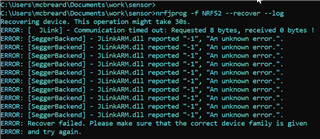

I have a DK board with nRF52832 that I've been using several months with no problems.
Today I wanted to try an experiment and did some modifications to the startup ASM file, and since then I am unable to reprogram. Initially, the jLink wa sno longer visible from my host system.
I tried the following sequence:
- put the DK in bootloader mode
- drag-drop the latest jLink file into the bootloader
- cycle the power (now the jLink is visible)
- try this command (see screenshot below)
I can also try programming with a jLink programmer I guess. Other than that, is there anything I can do? logfile attached

    You should not be able to brick the device even if you are playing around with the startup files. The only known configuration/condition that can cause the chip to become in an unrecoverable state is the one described in the errata here: [176] System: Flash erase through CTRL-AP fails due to watchdog time-out.

    Sounds like it could have been a temporary bad USB connection? The FW running on the nRF should definitely not affect how the Jlink FW runs on the interface MCU.

    The SWD interface is always available regardless of SWO/trace settings.

    It's usually a bad connection somewhere or wrong logic levels (i.e. mismatch between programmer and target). But there seems to seems to be some communication between the Jlink and nrf in your case at least.

    Could you try with the latest version of nrfjprog as well?
  • seemed to be some kind of hardware/wiring issue. The problem went away of its own accord. You may close this ticket, sorry for wasting your time with it.
