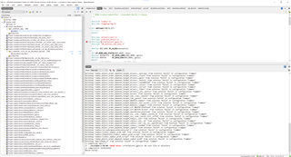

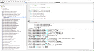

check i want to config P0.06 as output . How i suppose to configure here and i tried to make devicetree get binding but
#define NEO_NODE DT_ALIAS(neoswitch)
#if DT_NODE_HAS_STATUS(NEO_NODE, okay)
#define NEOSWITCH   DT_GPIO_LABEL(NEO_NODE, gpios)
#define NEOPIN      DT_GPIO_PIN(NEO_NODE, gpios)
void main(void)
    int err;
    const struct device *neo_dev;
    neo_dev = device_get_binding(NEOSWITCH);
    //if(neo_dev == NULL)
    //    return;
    err = dk_leds_init();
    if (err) {
            printk("LEDs init failed (err %d)\n", err);
            return;
    err = dk_buttons_init(button_changed);
    if (err) {
            printk("Cannot init buttons (err: %d)\n", err);
2. I am trying to implement #include <nrfx/hal/nrf_gpio.h>   based on this link https://devzone.nordicsemi.com/f/nordic-q-a/70735/gpio-pin-configuration/290413#290413
