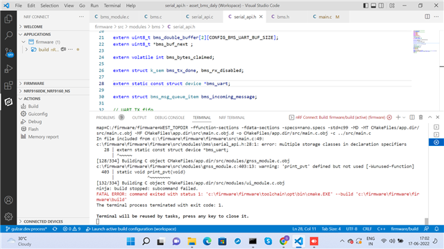

  • I need to access following variables in other files declared in one .h file ? I tried by copy and paste all this and extern before these. But, warning {useless variable space ....} is shown for some. There is one static const struct also to be globally accessible.  It shows multiple storage classes error for static device ... see the attached image.

    static const struct device *bms_uart;
