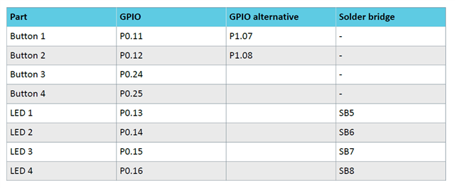

Functionality of four buttons and four LEDs
Could you please tell us the functionality or use of four buttons and LEDs on the nRF52840 DK(development kit).
    They can be used by the application running on the nRF52840.
