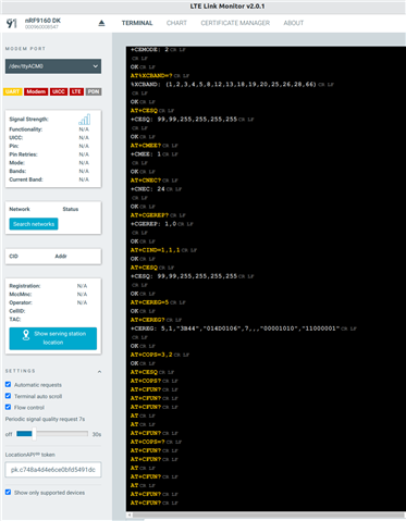

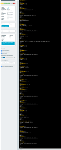

Test:
Connected to cell network, verified everything is working OK and no issues over 24 hours.
Wait 2-7 days

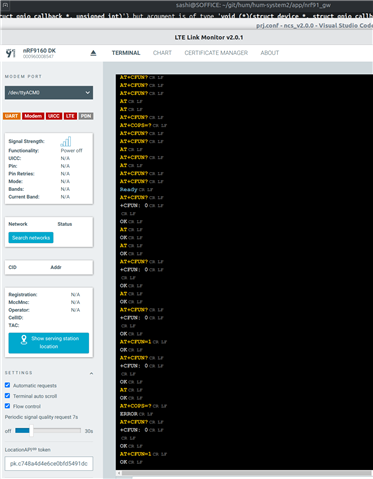

Device does not respond to AT commands, can not get Modem Trace from the device (may be other issue with app?) .
Device is not connected to the network.
Press reset on the PCB.
Device will respond to AT commands
AT+COPS=?, AT+CFUN? and similar commands don't result in connecting to the network.
Power Cycle DK board (toggle on/off switch): remove USB and reconnect USB. the board will reconnect to the network and work correctly.

  • Could you please share the whole log file from LTE Link Monitor? Click on "Open log file" as shown below, and store the file.
    Could you please also collect the modem trace from when your board stops responding?
