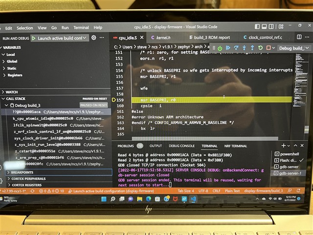

Hi Folks,
I am bringing up a new printed circuit board with a Fanstel BT840 (nRF52840). When I install any firmware, even Blinky, it simply gets stuck in k_cpu_atomic_idle. It never reaches a breakpoint set at main().
Both Blinky and my application run fine on a nRF52840 DK, and on the nRF52840 Dongle.
I have confirmed that my JTAG probe is able to install the firmware on the BT840 successfully. I've built two different boards to help assure it isn't a soldering issue. I've included the external crystal.

  • Hi Steve,
    I am facing similar issue on Fanstel BT 840 using nRF SDK - nRF5_SDK_for_Thread_and_Zigbee_v4.1.0_32ce5f8. The issue seems to be with clock setting but I am not sure about it.
    In your case, you can try setting appropriate clock settings. For that you need to recompile the application, instead of using prebuilt hex.

  • Thanks for the tips, Rajendra. Much appreciated. I'm using Zephyr, but I think your advice that it has to do with the clock is right.  My next steps are to get an EV BT840 and make sure it all runs on their board before diagnosing my board.
