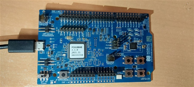

Thanks for your response.
I’ve tried all of your suggestions. Even tried to turn it on in Boot mode. The card isn’t detected by the computer at all, and no led is on.
In addition, the card heats up a lot at the PCA10040, and the current passes well in the pins (a voltmeter displays 4.83V connected between the GND output and 5V).
Do you have any other assumption ?
Best Regards.

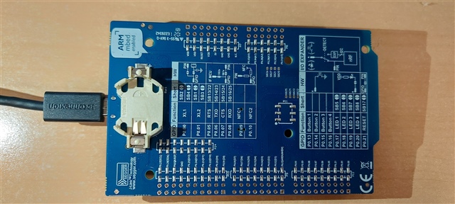

If the board heats up, there could be some short circuit somewhere. Have you made any modifications to the board? Can you upload pictures of both sides of the board?
Are you powering the board through USB, or through external supply?
I've made no modifications to the board and I'm powering it through USB.
Sorry for the slow response. Which part of the board is heating up? Is there a specific chip on the board that gets hot? Do you have an estimate of the temperature?
I checked with our board designers, and they had not experienced this issue before.
Jørgen
