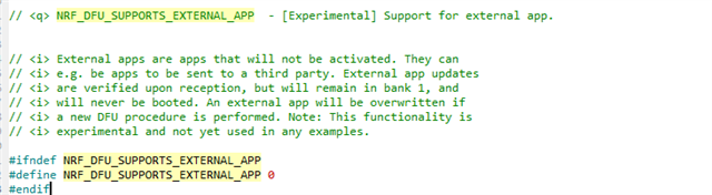

    To support external apps you have to enable this setting in your bootloader:
    So you have to implement a routine which can copy the image from bank 1 and forward it to your external device. A good place to do this may be from nrf_bootloader_init() before nrf_bootloader_fw_activate().

    According to what you mean, that is to enable NRF_DFU_SUPPORTS_EXTERNAL_APP, and forward the received firmware to the external MCU according to the custom DFU protocol before nrf_bootloader_fw_activate(), right?
