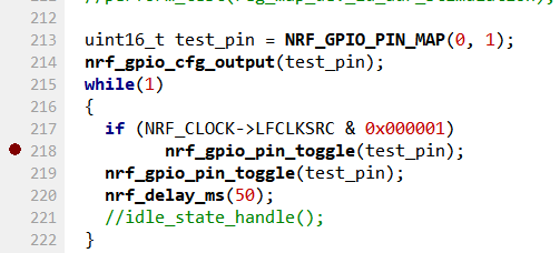

As the title suggests, I am unable to set P0.01 as a gpio output. I know this pin is also used to source an external LFCLK, however I am using the internal RC clock.
I have the following defines in sdk_config
#define NRFX_CLOCK_CONFIG_LF_SRC 0
#define CLOCK_CONFIG_LF_SRC 0
#define NRF_SDH_CLOCK_LF_SRC 0
Also, I have made sure that NRF_CLOCK->LFCLKSRS is set to 0, yet I am still unable to toggle P0.01 as a gpio pin.
Below is the code I am using to try and test this pin, it works for other pins just not P0.00 or P0.01.
uint16_t test_pin = NRF_GPIO_PIN_MAP(0, 1);
nrf_gpio_cfg_output(test_pin);
while(1)
     nrf_gpio_pin_toggle(test_pin);
     nrf_delay_ms(50);
P0.01 just stays low the whole time. Also, I am using the mbn52832 module dev kit with nrf sdk 16, schematic is here mbn52832_schematic.pdf (murata.com).
I have removed R46 and R45 and placed a 0 ohm resistor at R43 and R44 to ensure that the output pin is connected directly to the mcu.
Any insights into what the problem might be would be greatly appreciated,
