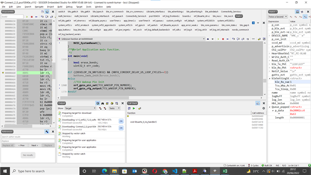

I am using nRF52805 in my application development(), everything working fine and power management is initialized using "power_management_init();" function. But i was not calling "nrf_pwr_mgmt_run();" in the while(1) loop as that time, I don't need power optimization.
Now, I need to implement power management, so i called "nrf_pwr_mgmt_run();" function in while(1) loop. After calling this function my application code gets stuck somewhere as shown in attached picture. After analyzing sequence of function in "Call Stack". I came to know "Libuarte" module is the problem, so I commented all the function & settings and again tested for the same, but still same issue persists. so my question is, is there any limitation of using "Power Management" or  I'm missing something. Actually I'm not able to find out where is the problem.
