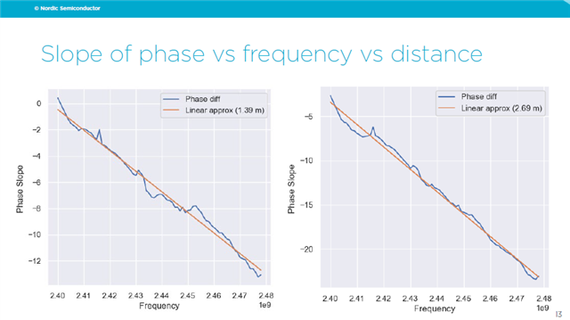

I am planning on using the Nordic SDK for some distance measurements between two nRF52840 boards.
For my documentation I would also want to understand how the technology works. I was following the Webinar on the different distance measurement methods (Phase Slope, IFFT, High Accuracy, RTT) but I do have some questions.
How is the phase slope calculated from the phase difference? In the presentation slides the phase difference is 0.52pi (for a distance of 2m) but the diagram in the following slide shows completely different values on the y-axis (here 1.39m and 2.69m). What is shown on that y-axis and how do I get from the phase difference to the graph?
