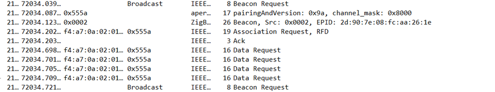

As coordinator, mlme_associate_resp from 802, MAC-lib, gives ASSERTION FAILED
I am using the 802_15_4 MAC api to configure my device as a coordinator.
After it has been configured as a coordinator I want another device to connect to it.
I can see by sniffing the channel that an association request is sent from the device and I can see that an association_indication on the coordinator is received.
When I then try to send an association response with
void mlme_associate_resp(mlme_associate_resp_t * resp);
I get an assert fault from the precompiled library:
00> <info> app: Assertion info: fsm:20004dc4,s:0,e:9
00>
00> <error> app: Assertion fault: !(p_fsm->recursion_protection == 0) line: 310 file: sys_fsm.c
00>
00> <error> app: ASSERTION FAILED at sys_fsm.c:310
Further more, the association_response is not sent and the radio stack freezes, i.e. no mlme function calls will trigger a callback.
Anyone have a clue what the assert fault is from?
I am using the structure defined in the library and I have tried both static declaration and using malloc to keep the structure in memory long enough.
Sniffer trace:

    We see that you call mlme_associate_resp() function directly from panEnterAssociateInd() handler, we think calling mlme_associate_resp() from IRQ context might be the cause of the error message.
    Can you try to pass execution context to the thread and then call mlme_associate_resp() from the thread instead?
    Kenneth
    Thank you for your response.
    I moved all code from panEnterAssociatedInd() to another function, leaving only a flag and a memcpy().
    The code was moved to another function which is called from main loop when flag is set.

    I no longer get the assertion fault which is great!
    However the sniffer-trace still looks the same (no associate response actually sent) and the radio stack freeze still occurs.
    I did not receive any other error messages either.
    Any idea what could be stopping it from sending a response?
    BR
    Linus
