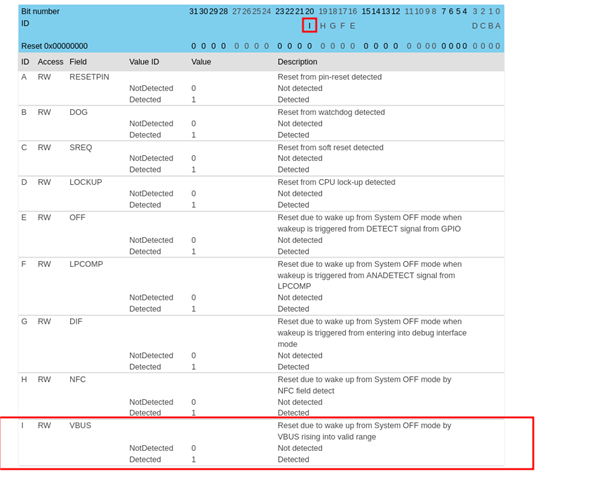

we are developing a device which should go to system off on receival of a command either via USB or BLE. If the device is connected via USB and is put into sleep it wakes up if the cable is disconnected. But it should stay in system off. Any idea why this happens and how to avoid it.
