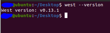

    If this returns something similar to:
    Then you can move on to step 3 in the installation guide. If you get the message "west is already initialized" in the folder you try to set up your version of NCS, then you either have to remove the .west folder located where you ran "west init -m https://github.com/nrfconnect/sdk-nrf --mr main" or install it elsewhere.

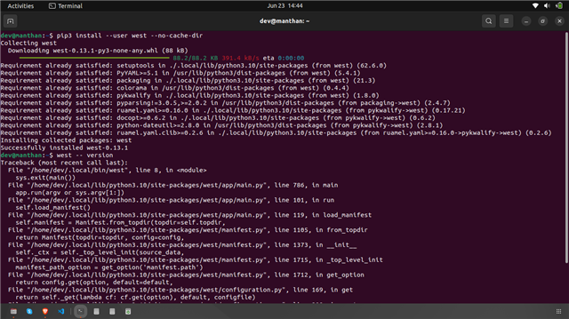

    i have tried but still i'm getting same error and I'll share my screenshot to you. Can you check and suggest me where i'm doing mistake?
    And tried to check in my system how many application are installed using "dpkg --get-selections | awk '{print $1}' "
    this command, But there is not showing "west". I don't know how/why it's happening in my PC?
    Thank you,

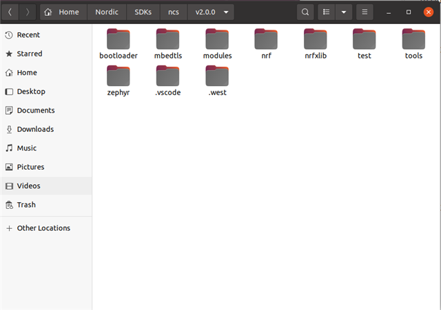

    1. Which command did you use to uninstall west?
    2. Did you try the solution in the ticket I linked earlier https://github.com/zephyrproject-rtos/west/issues/576? West tries to read ~/.west/config even with a failed installation so you need to remove the .west folder as well
    For 2) Try the following:
    1. Navigate to the folder you tried to initialize the SDK:
    2. If you don't see the .west folder, press ctrl+H
    3. Remove the .west folder (and everything else that is in the folder you have) either by opening a terminal and removing it with a command or delete the foldercd ~
    4. pip3 uninstall west
    5. west --version
      1. This should return something like "west is not recognized"
    6. pip3 install --user west --pip3 install --user west - -no-cache-dir
    7. west --version
      1. This should not give the error you are describing
    8. Move on to step 3 if everything is ok
    If you get any new errors, please add them in text form (insert -> code -> text)
