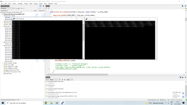

I'm trying to send a saadc float value over ble (dk to dongle) with ble_nus. I'm getting the right values but also some other stuff in addition. How can I filter this?
Hi Jorgen,
Thanks that worked!
Small question maybe you know the answer.
I´m reading my SAADC now nothing is put on and send it over ble. It should be equal to something as zero. When I have a COM-port open on PuTTY for the receiving part I receive +1 values, but after I open also the COM-port for the DK, which I send with, the val go to zero. Is this because nothing is connected on de AIN yet?
When nothing is connected to the AIN pin, the pin is floating, it is not connected to GND. It will then be affected by noise and other signals close to the pin, so you will read any arbitrary value from the pin, not zero.
