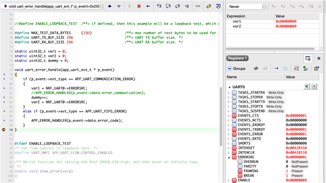

  • What happens here is that when you pause with the debugger, another issue is also triggered, so there is nothing wrong with reading the registers here. You can expand a bit to see it more clearly.
    First, remember that BREAK is 0x8 and FRAMING is 0x4, so if you have both you read 0xC. Now, we can modify the uart_error_handle() a bit more like this:
    static uint32_t var1 = 0;
    static uint32_t var2 = 0;
    static uint32_t dummy = 0;
    void uart_error_handle(app_uart_evt_t * p_event)
        if (p_event->evt_type == APP_UART_COMMUNICATION_ERROR)
            var1 = NRF_UART0->ERRORSRC;
            //APP_ERROR_HANDLER(p_event->data.error_communication);
            dummy++;
            var2 = NRF_UART0->ERRORSRC;
        else if (p_event->evt_type == APP_UART_FIFO_ERROR)

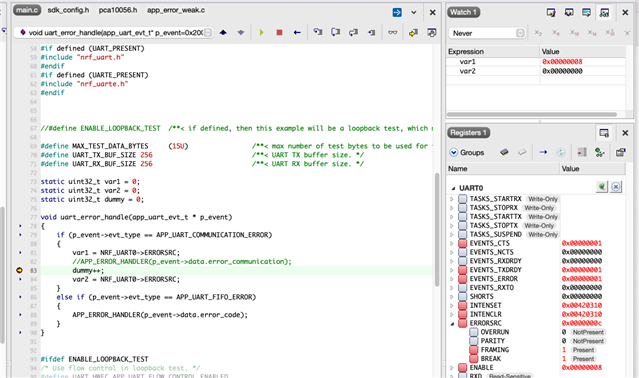

    If I set the breakpoint on the line with "dummy++" I will see this:
    Here the debugger shows that both BREAK and FRAMING are set, but if you look at the watch var1 only has BREAK. Now let me step a few lines so that var2 is also set, with the current ERRORSRC value:
    Here you see that var2 is 0xC, so both BREAK and FRAMING are set, which is the same as we see with the debugger.
    Now let us only set the breakpoint at the end of the function and run to it from the start:
    Here you see that both var1 and var2 is 0x8, so only BREAK was set originally. However, the register view also shows that FRAMING is set. So the FRAMING bit was set a bit later, before it was read out by the debugger.
    In other words, there is nothing wrong with reading the registers in any way, but it does not (and cannot) happen instantaneously, so depending on the timing you will see the change (remember that the UART peripheral is not paused just because the debugger pauses the CPU).
