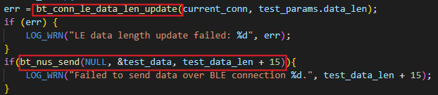

Failed to send a packet larger than 20 bytes over BLE
I tried to send a packet larger than 20 bytes by calling bt_nus_send on peripheral_uart but failed.
After checked on DevZone, I found some similar problem and did the following changes:
1. Add some configs in pri.conf:
CONFIG_BT_USER_DATA_LEN_UPDATE=y
CONFIG_BT_USER_PHY_UPDATE=y
CONFIG_BT_GAP_AUTO_UPDATE_CONN_PARAMS=n
CONFIG_BT_BUF_ACL_RX_SIZE=251
CONFIG_BT_GATT_CLIENT=y
CONFIG_BT_ATT_PREPARE_COUNT=2
CONFIG_BT_CONN_TX_MAX=10
CONFIG_BT_L2CAP_TX_BUF_COUNT=10
CONFIG_BT_L2CAP_TX_MTU=247
CONFIG_BT_L2CAP_DYNAMIC_CHANNEL=y
CONFIG_BT_CTLR_PHY_2M=y
CONFIG_BT_CTLR_RX_BUFFERS=2
CONFIG_BT_BUF_ACL_TX_COUNT=10
CONFIG_BT_BUF_ACL_TX_SIZE=251
CONFIG_BT_CTLR_DATA_LENGTH_MAX=251
CONFIG_BT_NUS_UART_BUFFER_SIZE=240
2. Calling bt_conn_le_data_len_update before bt_nus_send

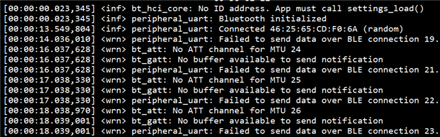

Unfortunately, still can't send a package larger than 20 bytes after these changes. The log is shown below:
Here are my prj.conf and main.c, is there something wrong?

void tlv_transmit_over_ble(void) //jjydebug
	if(current_conn){
		LOG_INF("ble connecting");
		TLV_Transmit_Host_Data(0, 0, 0, 0, 0);
		tlv_ble_update();
	else{
		LOG_INF("ble disconnecting");
#define INTERVAL_MIN 0x140 /* 320 units, 400 ms */
#define INTERVAL_MAX 0x140 /* 320 units, 400 ms */
#define CONN_LATENCY 0
#define MIN_CONN_INTERVAL   6
#define MAX_CONN_INTERVAL   3200
#define SUPERVISION_TIMEOUT 1000
static struct test_params {
	struct bt_le_conn_param *conn_param;
	struct bt_conn_le_phy_param *phy;
	struct bt_conn_le_data_len_param *data_len;
} test_params = {
	.conn_param = BT_LE_CONN_PARAM(INTERVAL_MIN, INTERVAL_MAX, CONN_LATENCY,
				       SUPERVISION_TIMEOUT),
	.phy = BT_CONN_LE_PHY_PARAM_2M,
	.data_len = BT_LE_DATA_LEN_PARAM_MAX
void main(void)
	int blink_status = 0;
	int err = 0;
	configure_gpio();
	err = uart_init();
	if (err) {
		error();
	if (IS_ENABLED(CONFIG_BT_NUS_SECURITY_ENABLED)) {
		bt_conn_auth_cb_register(&conn_auth_callbacks);
	err = bt_enable(NULL);
	if (err) {
		error();
	LOG_INF("Bluetooth initialized");
	k_sem_give(&ble_init_ok);
	if (IS_ENABLED(CONFIG_SETTINGS)) {
		settings_load();
	err = bt_nus_init(&nus_cb);
	if (err) {
		LOG_ERR("Failed to initialize UART service (err: %d)", err);
		return;
	err = bt_le_adv_start(BT_LE_ADV_CONN, ad, ARRAY_SIZE(ad), sd,
			      ARRAY_SIZE(sd));
	if (err) {
		LOG_ERR("Advertising failed to start (err %d)", err);
		return;
	uint32_t test_data = 0xfedcba98;
	uint8_t test_data_len = sizeof(test_data);
	for (;;) {
		if(current_conn){
			err = bt_conn_le_data_len_update(current_conn, test_params.data_len);
			if (err) {
				LOG_WRN("LE data length update failed: %d", err);
			if(bt_nus_send(NULL, &test_data, test_data_len + 15)){
				LOG_WRN("Failed to send data over BLE connection %d.", test_data_len + 15);
			test_data_len ++;
		dk_set_led(RUN_STATUS_LED, (++blink_status) % 2);
		k_sleep(K_MSEC(RUN_LED_BLINK_INTERVAL));
