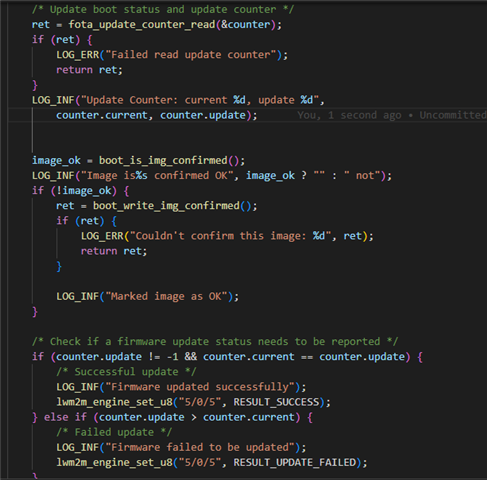

    The print outs indicates that your logic is done in the application space. Can you share how you handle this after a successful download?
    Håkon
  • Can you share how you handle this after a successful download?
    It's more or less from lwm2m_firmware.c from nrf/subsys
    Also, i marked as comment the log info of counter value.
    That's what i get now -->
    Also, it still doesn't work after i added pm_static.yaml file into my project
