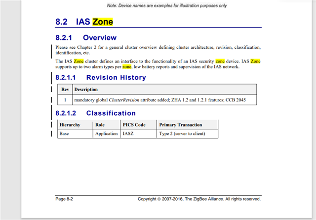

    In modules for the ZigBee stack API you can navigate to Zigbee stack API > ZCL API and from there see the clusters from there. In general I would recommend some additional resources, such as the ZigBee Cluster Library Specification (We're currently on revision 7) from the former ZigBee Alliance.
    The Cluster Library Specification does not help answer this question, as I'm asking about the SDK and not the spec itself. I'm simply looking for pre-defined types for these clusters. It appears that some of the clusters defined in the SDK have these types for their attributes in the SDK and some do not.
