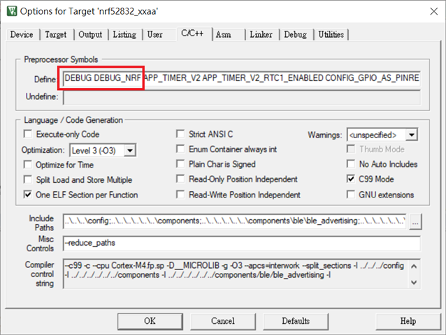

I try to using nrf_fstorage_write() to write data to fstorage and then waiting writting finish. But it hang at sd_app_evt_wait().fstorage.h

  • The following log messages show that fatal error occur in sd_app_evt_wait(). Where "pm e" means entering sd_app_evt_wait() function and  "pm x" means leaving sd_app_evt_wait() function

    The error is not form within sd_app_evt_wait(). The log states "Fatal error", which means that the error handler is called. Please make a debug build (define "DEBUG" and "DEBUG_NRF" for the project, or simply select the debug build target if using a SES example project that include it). Then the log should state the file name, line number and error code, and we will know much more. What information do you get then? And which function call does the error come from?
  • Thanks for your reply! The following is error messages after defining define "DEBUG" and "DEBUG_NRF". But I can't find useful information.
     0> <debug> app: pm e
     0>
     0> <debug> app: pm x
     0>
     0>
     0> <error> app: End of error report
    Aha, that is odd. It could be that there is an issue with the logger somehow. Instead of digging into that you can find the information another way, by setting a breakpoint in app_error_fault_handler() in components/libraries/util/app_error_weak.c and finding the filename, line number and error code there by inspecting the p_info.
