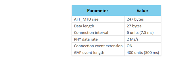

  • I think I have found the root cause. The time between two packet transfers takes about 25msec. That is the BLE_GATTS_EVT_HVN_TX_COMPLETE  event fires every 25msec. So the question is how can I make the transfer faster
    Maybe you can try to set the connection parameters as in the throughput example?:
    regards
    Jared
  • Hi, no this does not work. In fact it makes the transmission much slower (1.7kB/sec).
    With the previous settings the transmission reached 17kB/sec.
  • NRF_SDH_BLE_GAP_EVENT_LENGTH is set a bit low, have you tried increasing it? Could you use nRF Sniffer and provide the sniffer trace when you send data with your original connection parameters?
