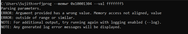

We are using a nRF52840 based module-BT840F used dongle USB840F from Fanstel and facing Vdd setting to 3.3V failed issue.
The nRF52840 is used in High voltage mode, please refer the schematic to confirm:
After chiperase vdd is falling to 1.8V and we are not able to set it basck to 3.3v using the following command provided in Fanstel documentation
nrfjprog --memwr 0x10001304 --val fffffff5
Please find attached the log.nrfjprog_log.txt.log
we have also tried the above command by providing external 3V supply from nRF52840-DK but having the same error.
Please help to resolve this issue.
