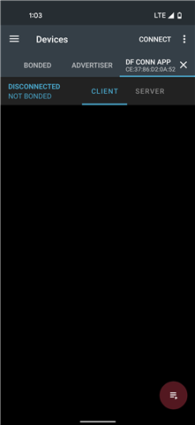

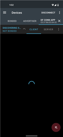

I have been experimenting with the direction_finding_peripheral sample in the nRF Connect SDK. I have been trying to connect to the peripheral using a custom device (not the direction_finding_central), wit no success. I also tried connecting using the nRF connect app. Even though it's showing app and I have the option to connect to it, when I click connect, it loads and never actually establishes a connection (gets disconnected after a few seconds without showing the GATT services on the device). I am pretty sure it has to do something with these two config setting in nrf52833dk_nrf52833.conf file:
  • CONFIG_BT_LL_SW_SPLIT=y
  • CONFIG_BT_LL_SW_LLCP=y
But enabling these is required for the CTE to get initialized properly. When I disable them, CTE cannot be configured properly but i can connect to the peipheral and see the GATT services. Any ideas as to why this happens, or any ways to work around it?

  • Yes, I managed to try with two nRF52833dk and they get connected normally.
    But when I try with the nRF connect mobile app in order to be able to read the GATT services provided. it tries connecting for a couple seconds and then times out / disconnects (reason 0x13).
    I haven't changed any of the default configuration.
    And I haven't tried sniffing the connection but I definitely do that. Is there anything in particular I should be looking for?
