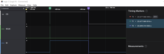

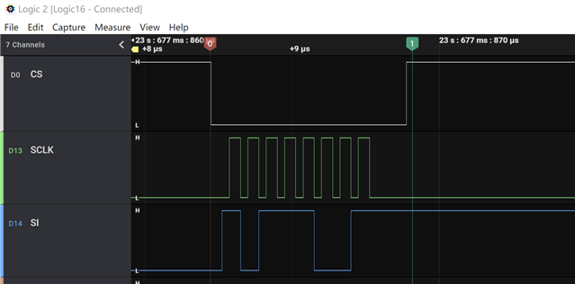

  • Hi Bon,
    I met the same issue and do you have any tips/solutions?
    After called pm_device_action_run(qspi_nor_dev, PM_DEVICE_ACTION_SUSPEND) in my application code,
    From RTT log, I can see enter_dpd() and nrfx_qspi_uninit() entered
     00> [00:00:02.043,701] <dbg> qspi_nor.enter_dpd: enter_dpd enter
     00> [00:00:02.044,128] <dbg> qspi_nor.qspi_nor_pm_action: nrfx_qspi_uninit
    And I collected wave form, it is properly set the dpd command to external flash (0xB9), and then CS is set to high after that
    But after around 13 ms, CS and SI were set to low
    I have no idea how the CS has been set to low and I am looking into the nrf qspi driver.
    IMO, the sample code running on 52840DK will have the same result.
    Anthony Yuan
