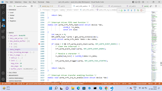

    In this the issue is that, I sent 13 bytes from Serial Device, after receiving 8 bytes, isr_wrapper file is called, pointing to the problem a shown in image.
    I gone through the library function uart_fifo_read(). After Stepping through the ISR code, I reached to the function shown in image below.
    In this function, size>0 is only used and nowhere (size) number of bytes is captured to be equal to. The following code line saves only one byte always rx_data[0], because every time at the start of function is num_rx = 0.
    rx_data[num_rx++] = (uint8_t)data->rx_data;
    I practically verified that only one byte is saved at index of rx_data[0] in every iteration and after 8 characters receive goes to isr_wrapper.
    1. What is use of third parameter in uart_fifo_read(x,x,Buffer_size) when it has not been used in implementation ?
    2. What is the issue related to isr_wrapper ?
    3. Does UART generate interrupt after every byte or may it be configured to interrupt after collecting Buffer_size bytes ? If yes, where to set ? If no, then, why to specify in uart_fifo_read() ?
     4. In the above ISR function, problem is in RX portion only, TX working well.
