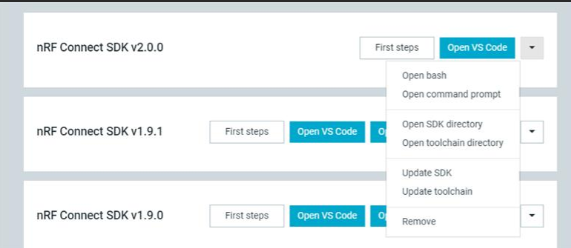

I have installed the NCS toolchain using the Toolchain Manager app. I am using toolchain version 2.0.0. Here is the error I get when running `west status` :
