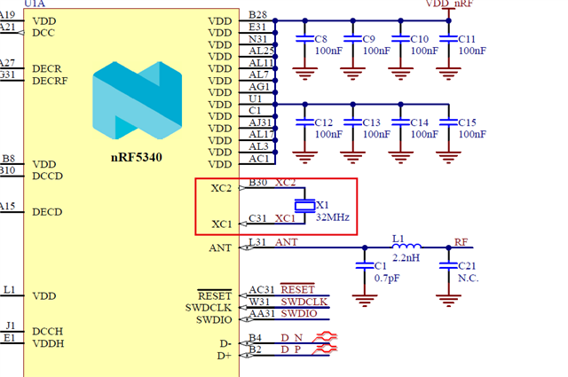

I have a problem and would like to ask you  about the  frequency offset of NRF5340.
As  we all know, if I would like to adjust the frequency offset of NRF52 series chip, I can adjust capacitance next to 32M crystal oscillator.
I read the design of NRF5340, the 32M crystal oscillator side does not have capacitance.
So I would like to know how to adjust the frequency offset of NRF5340.
Our customer's board used the NRF5340. Its frequency offset is 38KHz. They would like a smaller frequency offset.
Did I need to use software to change frequency offset or change cap. next to 32M oscillator?
If it needs to use software to change frequency offset, how to modify in the DTM program?
Best regards.

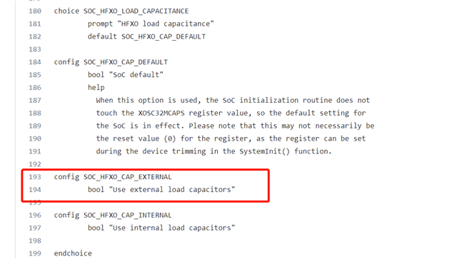

    I read these conversations and I tryed to modify them into the DTM program.
     How to use internal capacitors on nrf5340?
     RE: Can the software adjust the internal load capacitance of the nrf5340 crystal oscillator
    1、I will try to add the following code to the NCS\v1.9.1\nrf\samples\bluetooth\direct_test_mode\prj.conf file
    CONFIG_SOC_HFXO_CAP_INTERNAL =y
    CONFIG_SOC_HFXO_CAP_INT_VALUE_X2 =20
    But it seems not to be applied.
    2、I read the following link.
    It means that I can use  external load capacitors.
    So how can I set the code to use external load capacitors.?
    3、
    I try to add the following code to the main.c of direct_test_mode.
    #include <hal/nrf_oscillators.h>
    nrf_oscillators_hfxo_cap_set(NRF_OSCILLATORS, false, 0);

    you need to write these values in the prj.conf
    in the empty_app_core.
    In this way, you can change the values of internal capacitors.
    Alternatively, you could use only
    CONFIG_SOC_HFXO_CAP_INTERNAL =n
    to disable internal ones in software (in the same prj.conf) and then add external capacitors.
    Kaja
