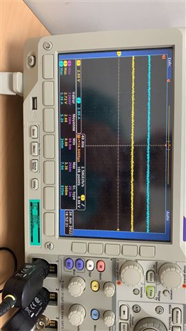

Hello ,

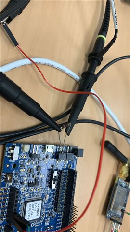

I on the DK nRF52840, I wanted to manage the sleep mode and measure the current consumed by the microcontroller.
I started with example uart, I cut the PCB track courting solder bridge SB40 and I soldered a 10 Ω resistor .
the current measured with oscilloscope 0.216A (
I measure the voltage between the resistance and i divide by 10 ).
, and once the microcontroller goes to sleep, I measure 0.241A, which means that the microphone does not go into sleep mode . can you help me please .
why it doesn't go to sleep ?

    I think you need to look more closely at how you measure the current before you look at the SW.  You are seeing over 200 mA and is an enormous current consumption, which you should never see regardless of the state of the nRF, so i very. much suspect a measurement setup issue of some sort. Are you sure the resistor is 10 ohm? Can you double check? Or could there be an issue in how you measure the voltage over it?
  • Hi Einar,
    by information, I powered the card with a 3.3v battery, SW9 on VDD, SW6 on DEFAULT .
    Thank you

    You have a simple while(1); at the end of your main loop, which causes the CPU to spend time doing nothing. To put the CPU in sleep mode you should instead make your main loop look something like this:
        while(1)
            // Clear the internal event register.
            __SEV();
            __WFE();
            // Wait for an event.
            __WFE();
    (Note that if you had been using a SoftDevice you should use sd_app_evt_wait() instead of WFE).
    Note that even though the CPU sleeps (after WFE) the HF clock and UARTE peripheral ect will consume a significant amount of current while the UART is enabled, so you probably want to disable libuarte as well when you no longer need it (using nrf_libuarte_async_uninit()).
