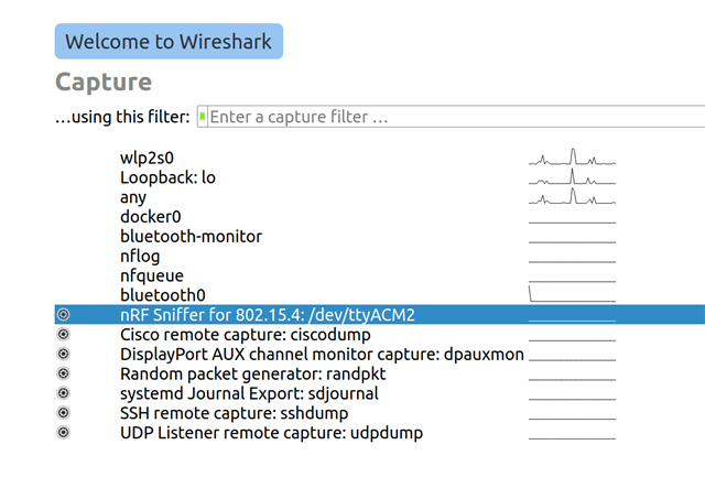

I plug in the dongle and I can see it in the interfaces list as "nRF Sniffer for 802.15.4: /dev/ttyACM2":
