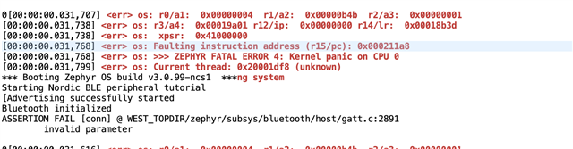

  • after much experimenting I seem to be getting this error from the second example.

    	printk("Starting Nordic BLE peripheral tutorial\n");
    	err = bt_enable(bt_ready);
    	if (err)
    		printk("BLE initialization failed\n");
    		error(); //Catch error
    	/* 	Bluetooth stack should be ready in less than 100 msec. 								\
    		We use this semaphore to wait for bt_enable to call bt_ready before we proceed 		\
    		to the main loop. By using the semaphore to block execution we allow the RTOS to 	\
    		execute other tasks while we wait. */
    	err = k_sem_take(&ble_init_ok, K_MSEC(500));
    	if (!err)
    		printk("Bluetooth initialized\n");
    	} else
    		printk("BLE initialization did not complete in time\n");
    	err = my_service_init();
    	for (;;)
    		// Main loop
    		my_service_send(my_connection, (uint8_t *)&number, sizeof(number));
    		number++;
    		k_sleep(K_MSEC(1000)); // 1000ms

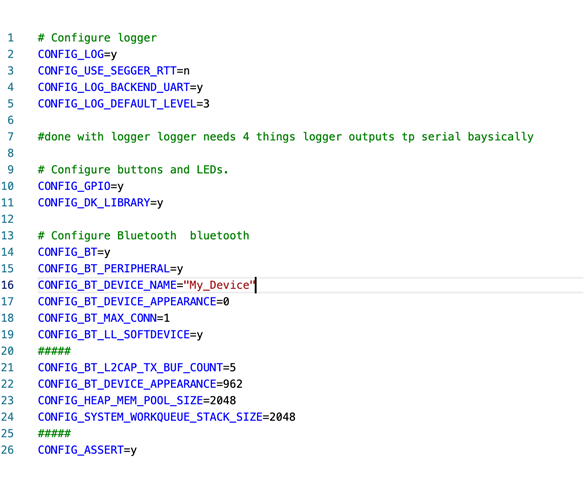

  • attached main and header below here is my prj.conf
