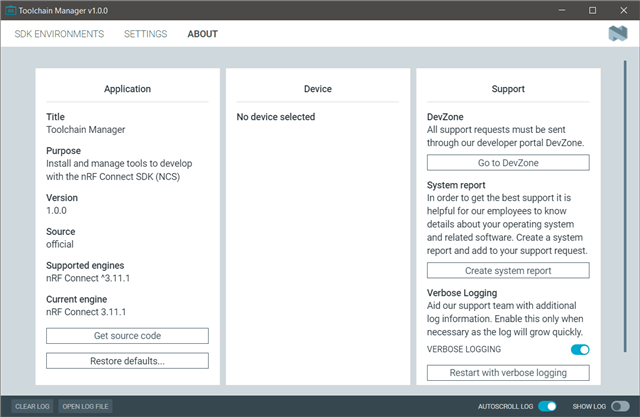

    Are you behind a firewall? Do you have access to github.com? The SDK is downloaded from github. Can you try to enable verbose mode under settings of Toolchain Manager

    this is what it show after verbose enabled. it still do nothing for sdk. it just clone github rep? is there anyway i can do it manually?

  • I am experiencing the same issue on Fedora 36. With verbose logging enabled, the output is the same:
    However, opening the log file gives more information:
