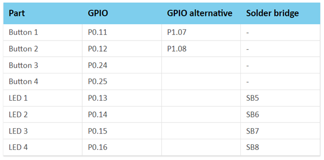

    I've had a chance to reference the pinctrl documentation.
    I switched my MOSI to P0.27 and all started to work correctly with the sensor. I have a feeling that the  GPIO pins I was trying for MOSI are hooked up to other peripherals on the DK and some interaction there was resulting in the voltage difference on just MOSI, but I'm not 100% sure.
    If there's any additional insight on this topic that might come to mind for you, please let me know. I'm left wondering if I was doing something fundamentally incorrect with the DK hardware or my configuration (e.g. DTS or code).
    Based on the nRF52840DK HW User Guide it seems that you have tried to use the LEDs for SPI communication. Have you disconnected these (If intentionally used)?
    Also, P0.17 is connected to the external memory on the DK. To use this pin, please see the Solder Bridge Configuration
    This is also visible on the back of the board.

  • That makes a lot of sense, and explains the behavior I was seeing with MOSI and the LEDs.
    From devboards I've used in the past, my assumption was that "if it's on the headers, it's not bound to anything else and is ready to use", but clearly the NRF52840 DK is more flexible than that (which I think is a really good thing) and I should've perused the documentation for it more carefully.
