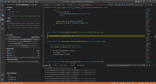

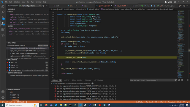

Any idea what I'm doing wrong or what I'm missing?  I watch the pins on a logic analyzer and the CS line gets configured and goes high and then never goes low.

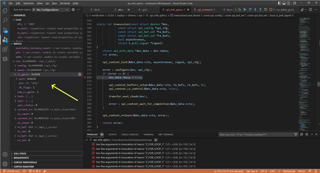

  • So I think I found the answer on my own.
    This seems to work, I have commended out the old stuff and left in the new stuff
    static struct spi_cs_control spi_cs = {
        // this is the new hottness
        .gpio.pin = 18,
        .gpio.dt_flags = GPIO_ACTIVE_LOW,
        // below is the old depricated way
        // .gpio_dev = NULL,
        // .gpio_pin = 18,
        // .gpio_dt_flags = GPIO_ACTIVE_LOW,
        // .delay = 0,
        // old and busted
        //spi_cs.gpio_dev = gpioPort0;
        // new hottness
        spi_cs.gpio.port = gpioPort0;

    I think they want us to use the gpio_dt_spec struct from now on, not the old structure in that union.
