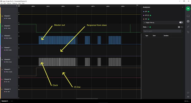

Any idea what I'm doing wrong or what I'm missing?  I watch the pins on a logic analyzer and the CS line gets configured and goes high and then never goes low.

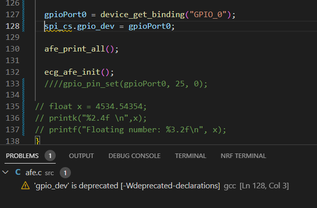

    now all the examples I have seen with SPI had .gpio_dev set to NULL.  And it worked in SDK 1.9.1.  But since I'm in a "I'll try anything" I did this:
    const struct device *gpioPort0;
      gpioPort0 = device_get_binding("GPIO_0");
      spi_cs.gpio_dev = gpioPort0;
    By setting .gpio_dev to that, I get the compiler message that .gpio_dev is deprecated:

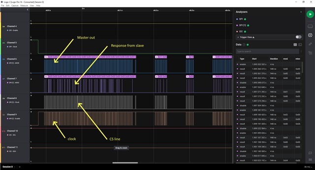

    But that made the CS line work.
    Before setting .gpio_dev
    After setting that
    So is .gpio_dev deprecated?  Does that mean I should stop using it?  Why was this not needed in 1.9.1 and it's now needed in 2.0.0?  And if it's deprecated is there something else I should be doing to make the CS line work with SPI in SDK 2.0.0?
