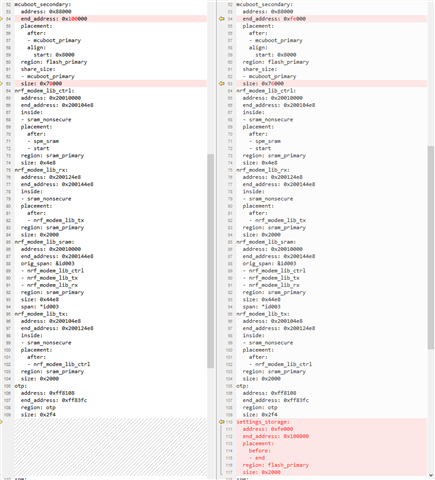

I have enabled mcuboot and have two boot partitions: primary and secondary. I'm using a static flash configuration. I want to start using the settings subsystem for persistently storing configurations in flash. To make room on the flash for the settings, I have reduced the size of the mcuboot_secondary from 491kbytes to 483kb bytes. My app_update.bin is 410kb, so it still fits within the partition.
I have 3 fw versions:
v10: old flash layout
v11: new flash layout
v12: same as v11, but higher fw version.
For fota I'm using the download_client. I have flashed v10 and starting fota with v11. This works fine and the new image boots correct. The problem arises when trying to do fota the second time. I'm now running v11 and want to do fota with v12. This image will download correctly, but when rebooting it will start up v11, and not v12.
For all versions up to v10, fota works fine. If I first flash v11, then do fota with v12 and so on, everything works fine. The only change from v10 to v11 is the static flash configuration, there is no other change in there.
What am I doing wrong? Since I want to start using settings subsystem, I need to reserve some space for it on the flash. Anyone having some experience with this problem?
BTW: manually flashing the new sw is not an option since we have products already delivered to customers.
The difference between the two static configurations looks like this:
I have also attached the static configurations for the two different layouts.

mcuboot_secondary:
  address: 0x88000
  end_address: 0x100000
  placement:
    after:
    - mcuboot_primary
    align:
      start: 0x8000
  region: flash_primary
  share_size:
  - mcuboot_primary

mcuboot_secondary:
  address: 0x88000
  end_address: 0xfe000
  placement:
    after:
    - mcuboot_primary
    align:
      start: 0x8000
  share_size:
  - mcuboot_primary

settings_storage:
  address: 0xfe000
  placement:
    before:
    - end
