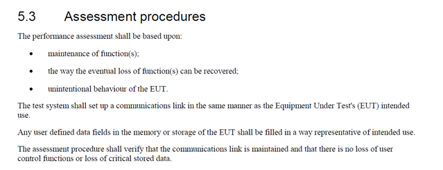

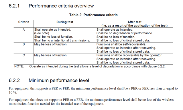

    Essentially it is the EN 301 489-17 document that set the requirements. The assessment procedures are defined in chapter 5.3:
    And the performance criteria in 6.2 (in your case criteria A would be used):
    In the end this is a self declaration, so it is up to you what firmware to put into the device, but the more divergence there is between the test firmware and the actual firmware then the higher the risk that potential issues are not discovered.
