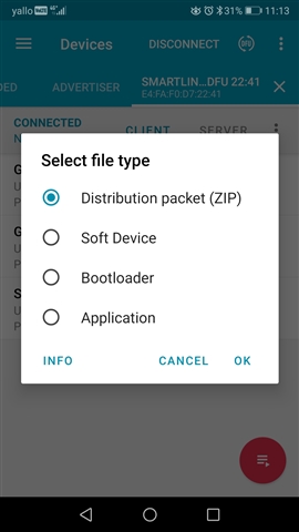

Is there a possibility to update the bootloader himself over the BLE DFU?
I have a new bootloader with a bigger size (MemoryMap changed) and I am wondering if I can upload old boards with the small bootloader over BLE DFU with the Nordic nrf Connect App, because there is under SelectFileType (Bootloader). Is this possible only if the size and memory map is equal or even if the size is bigger?
I checked if I can download te new Ditribution Packet (ZIP) on the old device with the old small bootloader, and yes, its possible. The application is new but the bootloader is still the old one. Even after Powereset the application is running wit the old bootloader, this makes me a little bit confusing, ow is this possible?

    This is working, but only after flashing the RF over SWD with the programmer.
    If I update the file with nrf connect app and send the zip packet, this changing was not active. Why? The bootloader will be updated with the zip packet aswell, but the SDK config settings not?

    The sdk_config.h file for the bootloader is used when building the bootloader. That is then part of the resulting binary file. So regardless of how you update the bootloader, as long as it is successfully updated, all and any changes will be included (as you get the exact same binary bootloader file programmed in the end regardless of method being used).
  • checked again, not working with the new time if I choose this:
