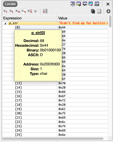

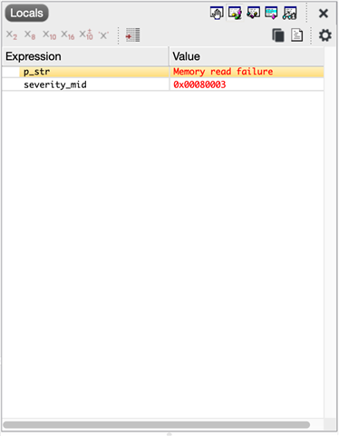

// debugger displays 'Memory read failure', mangled string printed,
// switch debugger to display array and we see the correct value.
char s[] = "some string";
NRF_LOG_INFO(s);
For the 3rd case, This is what it looks like in the debugger initially:
And if I change it to be of type `array`:
