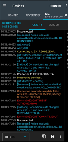

In both cases, when i try to connect with nrf connect android app, it gives me this result, no matter how many tries and with different smartphones

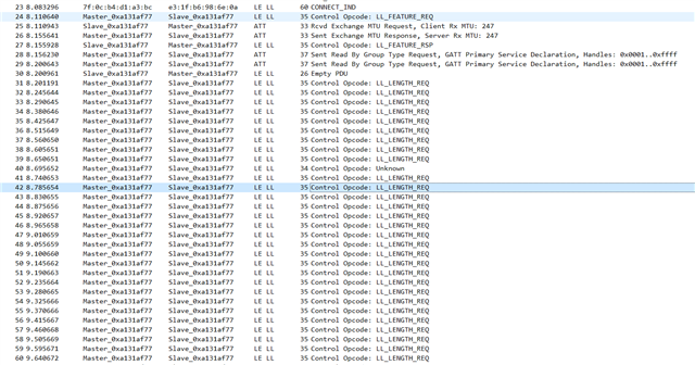

I captured the air trafic with nrf sniffer

Do you have any idea about the issue ? and why it works with NRF_CLOCK_LF_SRC_SYNTH and not with NRF_CLOCK_LF_SRC_XTAL or NRF_CLOCK_LF_SRC_RC ?
