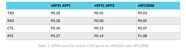

    We are using a NRF9160_xxAA_REV2 connected to a NRF5340_xxAA_ENGD, with the 01 to 14 pin connections:
    The same issue is not seen with UART0.
    Kimberly

    We have the nRF5340(used as the external MCU) outputting what it receives to a terminal. When UART0 is enabled, it reports receiving the “READY” signal from the modem at startup. When we try to run the same sequence with UART2, it does not receive the “READY” signal.
    Below are the accompanying signals.
    NRF9160
    D0 = RTS
    D1 = CTS
    D2 = TX
    D3 = RX
    UART0
    UART2
