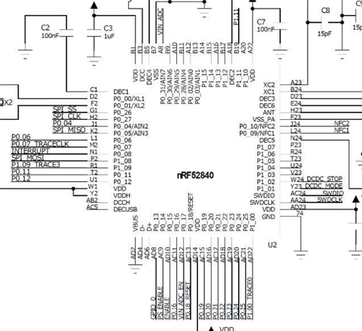

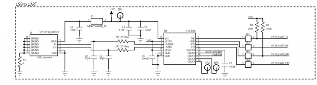

app_uart_get() and app_uart_put()
I want to use the functions app_uart_get() and app_uart_put() to communicate between the computer and NRF52840.
But when I type a string on the computer, the app_uart_get() function doesn't seem to receive it.
I'm using Segger Embedded Studio, the function app_uart_PUT()  is the same. What should I do?
    Which program are you using for this?
    Are you seeing any output from the nRF in your serial terminal at all?
    Please show examples of how you have used these functions in your code, if possible. You can use the insert -> Code option here on DevZone when sharing code.
    Karl
  • Thanks for your response, Karl.
    I hid some of the code that wasn't important. It goes like this:

    int acconeer_main(int argc, char *argv[]);
    		uart_config();
            		while(1)
    When I downloaded the program into the chip, the computer's serial tool showed an error:
    Then I tried to input some characters, such as "111", "1223", etc. in the serial port tool of the computer terminal, but it didn't work.
    What should I do, please?
  • If this is all the functionality you need to implement for now you can take a look at how this is done in the UART peripheral example - it receives characters typed from a connected serial terminal on a computer, and can do things based on the received character.
    For example, you can modify it to send a specific character back once it receives a specific character, etc.
    Then, once you have confirmed this to work you can move back to your existing application and merge the functionality that is confirmed to work back into it.
    Yes, that's the basic functionality, and in fact, the tutorial video I watched does that too. My ultimate goal is to do RS485 communication. I heard that RS485 communication is based on serial communication. So I want to implement serial communication first.
    Could you also share with me your sdk_config.h file, so that I may take a look to see if I can spot any potential issues?
    I would like to share my sdK.config.h with you. But it looks a bit wordy.I hope it's easy for you to read.
