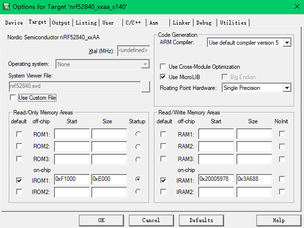

IROM1 size change 0xD000 to 0xE000,

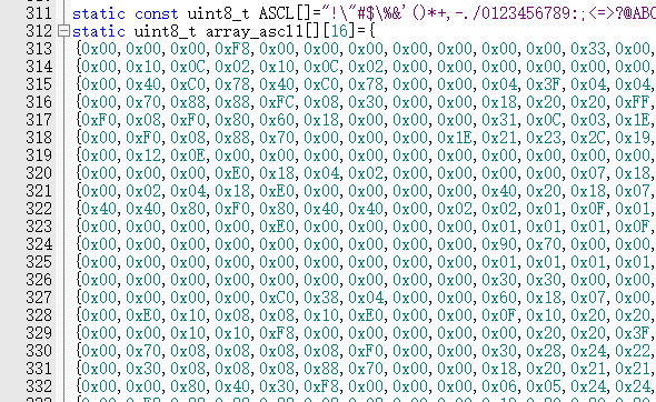

    After a night's effort, i find the problem is Font array is too large.
    i set array minimization, it can button reset, and all work well.
    large array in app work well,  but in bootloader will  destroy flash memory?
    or need set larger IRAM1 size. the max IRAM1 size is?
    The application and bootloader usually can use the same RAM size, as they do not run at the same time. Maximum RAM size is determined by the chip type, see Adjustment of RAM and Flash Memory tutorial.
