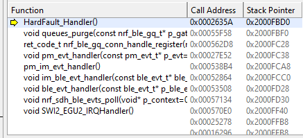

Got hardfault reconnecting to paird iOS device
We found this problem in our tests.
In our tests, one test leaves the device in a state of poor signal with the iOS device. The device is then regularly disconnected from the iOS device and reconnected.
After hundreds of reconnections, this problem occurred.
We use ANCS, so the iOS device is bonded to the nRF52.
We would like to know how we can prevent this hardfault from happening.
Env:
  • SoC: nRF52832
  • SDK: nRF5_SDK_17.0.2_d674dde
  • SD: s132_nrf52_7.2.0_softdevice
CallStack:
Call Stack
The related code in pm_evt_handler is below:
