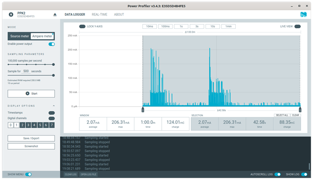

I'm wondering about the value of the time axis.

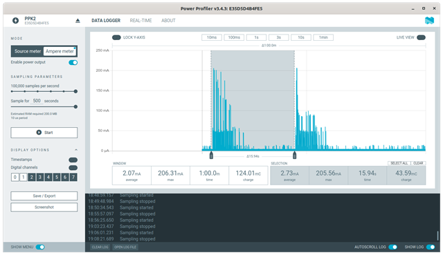

E.g. is send two messages. According all other logs, the second message is sent about 50s after the first.
According the Power Profiler, it's about 16s.
Also according this second screenshot, the time span (start - stop) in the log window is about 2:20, in the chart it's about 43s.
Seems, that the times displayed in the must in the chart must be multiplied by 3.
(As secondary issue, the value of charge must be multiplied by 3.)
