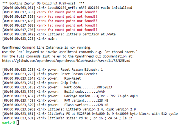

Is there a way to manually initialize the nRF5 802154 radio?. I am using an external NOR flash LittleFS partition for data and the nRF5 802154 radio driver keeps complaining about the mount point not being found. For boot speed reasons, I manually mount the FS later. Even if I used automount, the 802154 driver still gets initialized before the filesystem so this is still a problem. Ideally I would like to be able to mount LittleFS and then enable the radio from my application (post boot).

  • I’m using NCS v2.0.0. That error occurs during Zephyr initialization of the 802154 radio (NOT controlled by my application). This should be observed in any project where you enable LittleFS on external NOR flash and use it for the settings subsystem (I had no success initializing they settings subsystem in the internal flash when using external flash). The issue is apparently due to the radio loading before the file system is mounted (the settings subsystem in this case requires the file system to be mounted first). Due to the time it takes to mount the file system, my application cannot wait for it to mount (it takes about 700ms) and I require being able to manually mount after the application starts running. Therefore I need to do one of two things:
    1. Start the 802154 radio from my application (after the file system is mounted)
    2. Be able to use an internal flash partition for the settings subsystem AND still be able to mount LittleFS on the external flash.

  • Edvin,
    I see this same issue on my custom board as well as on the nRF52840DK.

    It is my understanding that the NRF 802154 driver uses the settings module and therefore will be looking for the storage back-end. In this scenario, the filesystem has not yet been mounted which is why the mount errors are there.
    Here is the Zephyr log at boot:
    In my projects device tree, I unselected automount. But if I were to rebuild with automount enabled, mounting takes place after the nRF5 802154 radio is initialized and I see the same mount point not found error as above.
    My project has preparatory code so I'll share the kconfig and board files instead. You should see the issue without my application just by applying the kconfig and dts since the issue happens during boot and not in the application.

  • Edvin,
    It is also possible that I misunderstood the error logs and the mount point error is coming from somewhere else, perhaps another module that requires the settings filesystem. For that, I do not know how to debug an NCS project to step through the Zephyr boot in order to root cause the source of this error. Any help would be appreciated.
