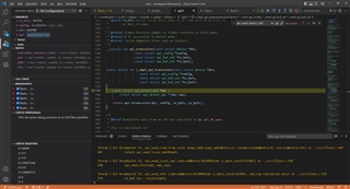

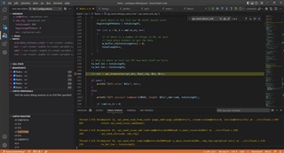

The problem is when want to get 510 bytes from SPI (and it adds in 4 header bytes, 1 command and 3 address) for a total of 514 bytes of communication, it works fine.  But if I call:
spi_nand_read_from_cache(0x01, 0, x);
where x = 511, for a total of 515 bytes of SPI transmission.  The whole thing crashes.  I can debug through
spi_nand_xfer(cmd, cmd_cfg);
and all the way down to
int err = spi_transceive(spi_dev, &spi_cfg, &tx, &rx);
I can debug to here

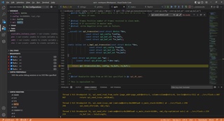

Then if I step into the spi_transceive() function
it goes to here
Then here

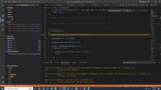

and then one more step it jumps back out to the beginning of my init code, with no SPI output.
How do I debug this.  I get no information or why it's moving to this point in the code.  It's basically the first breakpoint that I put in the code that gets hit when I was debugging.  Goes from SPI transceiver right to the first breakpoint I set. I don't know if it's crashing, or rebooting.  And it's not like there is any allocated memory.  If I make the loop go from 1 byte of data to 768 bytes, it will transmit over SPI 1 byte, then 2, then 3,.... etc to 510 and then when I hit 511 it crashes.  If I'm not debugging my whole application reboots and starts over.
